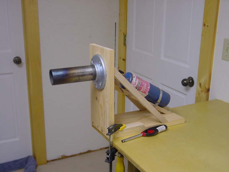

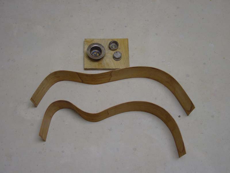

I’m new at this too, and if this is of any help, I just built my hot pipe jig 2 weeks ago. The first
time I tried it out, was last weekend, and had great success with one of the sides.
I still need to bend the other side for the cutaway. I already had a set of pre-bent mahogany sides for a
dreadnought. So, I decided to try and re-bend them to fit a OM mold. So far, so good! Of course
the real challenge, is when I try to do the cutaway side. However, I feel confident that it will work.
I got my information from the book William Cumpiano wrote “Tradition & Technology”.
I soaked the mahogany side in hot tap water, weighted it down in the bath tub for 10 minutes.
I had the pipe already going, so it was good and hot. I don’t want to say that it was easy, but, It
wasn’t very hard either. Like Hesh says, keep it moving, rock it back and forth, and you will feel
the wood relax. I kept my mold right next to me, and when I was satisfied with the fit, I held it
there for, maybe less than a minute. It holds its shape pretty quickly. I think the soaking was what
made it work so well, IMHO. But, when I was all done, I don’t think there was a drop of moisture
in that piece of wood.
The pics below show the jig, and the set of sides. The parts laying above the sides are what I used
to control the heat inside the pipe. Just a old sink drain, and a pipe cap served well as a baffle. The
side on the bottom is the side I bent to fit the OM mold.
Hope this helps,
Robert
